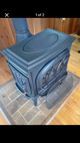

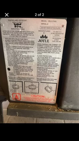

Here are the two pics I have. No date sticker on the metal tag like there is sometimes. Seller is retiring and moving. Says he replaced the ash grate and interior door panel along the way. Claims no cracks but won’t know until I get there I guess. 3 hour drive each way. He says he has a dolly to get it out of the house and I’m bringing an engine hoist to get it into the truck.

The outside looks to be in nice shape. If it’s not too far and a decent price I’d jump on it as long as the insides look good.

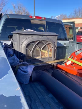

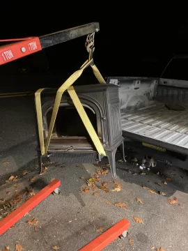

Took a 9 hour round trip yesterday (including loading the stove and lunch) and brought it home. Need to really clean out the stove better to investigate thoroughly, but seems nice on initial inspection. Fire bricks need replacement and the burn plate opposite the side door is cracked but so far, so good otherwise.
My wife and I basically deadlifted the thing onto a furniture dolly and rolled it out of the seller’s house. Made a makeshift ramp to get it down a few steps and hoisted it into the truck with the engine hoist. No damage from moving it.

You were well prepareed. I'm still wondering about its age. Does it have a cast iron or refractory baffle?
How did the base area around the grate look?

Front ash lip and ash pan door both have a casting date of 3-30-2000. However, it does have the later refractory baffle, so I’m guessing more maintenance work was done than the seller remembered. Given he thought the stove was from 1990, I guess that’s not a surprise.
Just vacuumed it out, no cracks around the ash grate at the corners. Next I’ll pull the top off.
