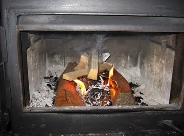

I used @BrotherBart 's Tunnel of Love fire starting method tonight, with great success! Just a Super Cedar, 6 small kindling, 6 larger kindling, and 9 splits. Cruising at 600F

I'm expecting 10hrs before reloading. Thanks for all of your help here.

Tunnel of Love™ starts are standard procedure here. The difference though is there is nothing horizontal (E/W) at the bottom of the pile. The idea is to allow air to get under the wood bed front to back as quickly as possible. Here is another variation using kindling as a kind of bridge for the wood laid on top so that air is still able to circulate front to back. By the time the "bridge" collapses the wood is burning vigorously.

This is for a cold start. On a hot restart with nice dry wood I just rake the hot coals to the middle front and reload the stove full.

A variation for E/W loading stoves like the Castine is to rake coals forward toward the front center of the stove. Then take two ~2" diameter short splits (about 12-14" long) and place them N/S about 4" apart centered in the middle of the stove. Then place your normal load of wood on top of those two splits. Branch material works great as a source of those short sleepers, but so does a 2x4 scrap split in half. Loading this way will allow air from the boost manifold to get under the bed of wood. This will greatly improve quick lighting.

I started burning this way with the Castine. It was the first E/W loader we owned and I got tired of slower smoky starts. Putting a pair of sleepers under the wood made a big difference. The trick is to allow air to easily travel from front to back under the kindling and firewood. This method translated to the N/S loading T6 for easy quick starts. This Oct. for shoulder season fires I was placing two bottom splits a couple inches apart, loaded N/S with a few balls of newspaper between them and kindling on top of the newpaper. Then I put two splits loaded E/W on top with a 1-2" gap between them. Light paper and off she goes. A 1/4 of a SuperCedar can be used in lieu of the newspaper with equally good results.
Man I wish I could do that. How long does it take to heat up enough to shut the air down?
I move the air damper halfway at about 15mins after lighting, fully shut at 30mins in. All secondaries at that point. My bridge in the front never collapsed allowing for outstanding air flow. Thank goodness I have a pipe damper!
