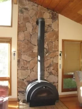

Here's a pic of the current set up.
Thoughs on stove size and single wall / double wall interior pipe?

looks like fuax stone, so not combustible, but prolly not an approved heatshield if no air spaces were installed.
measure thru the stone to nearest combustibles behind it for your rear clearance
but. why would you want to get rid of that radical stove??
Greetings Greg. That is a stunning setup. Very cool looking stove.
I'm with dealer #3. The Castine or Leyden may get balky or spill smoke with 3 90's in the flue path. Dealer 3's suggestion of getting everything to 6" is a good plan and the Oslo is a great stove.

The stone is cemented to the cinderblock chimmney behind which is 54" wide. The nearest combustable is the wall to the side of the stone. We used to have roaring fires in that stove and it is located 3" from the stone.
That "Radical stove" is a eyesore in the opinion of my wife.

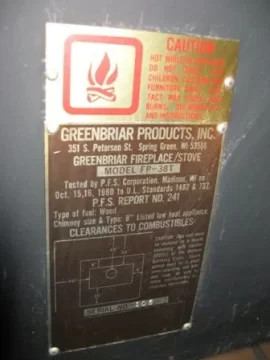

Okay had to search for the info. Maker Greenbriar Products of Madison, Wi The stove was slow to get going, I don't think the flue setup was optimal. ( 8" flue dumping into a cold clay liner. ) I used to prop the door to get the fire roaring and sometimes had to leave it open to get enough air to keep the fire going. ( wood wasn't seasoned. ) One the fire was going it kept my front great room toasty at 83' F.
Had a picture of the plate for insurance reasons.

Good choice. Whats up with that thimble beeing so high up? It's going to be a pain cleaning that system. How hard would it be to move that down?
Greeting Greg.
That sure is a radical stove.
Looks like you have to bend all the way down to feed it.
Never heard of the manufacturer before.
I like that set up. Pain to clean, but think of all the heat that will radiate off of that pipe into the room instead of outside.
