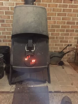

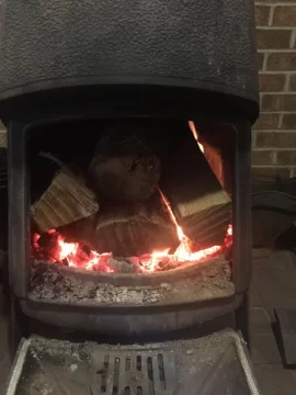

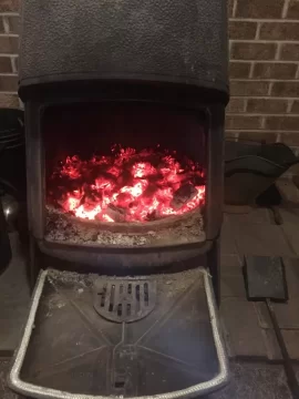

Getting the parts. Here’s some pics of the old girl in my cabin.

It was a decent heater. Looks like the hearth needs to be extended. It should extend out 16" in front of the door.
