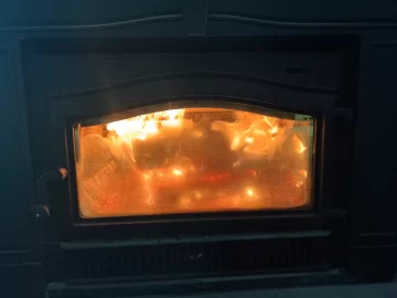

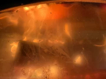

Two shots of a fire as normally loaded early on in cycle full vent. BTW the idiot that designed to vent control “knob” needs to have his fingers burned in an open fire as punishment for not even having used his own design.
What I’m seeing is a middle section of Cat/ tube is not firing or not heating up as a result . I’m not sure how the “tube” cat relationship or timing works but I have noticed the cats will hear up and glow before good tube airflow ? Do I have that timing correct ?
2 years old white oak, 300* temps at the cornerstone of unit.
OAT about 25*

Twenty minutes later :
Blower fan on 3/4 speed. (Speed control button broke off- so it’s a one speed unit now. Three calls to installer have yielded ZERO options as to replacement)
Temp up to 400*

Yes and no. The fire is hotter and burning quicker, but when the air control is wide open or near to it, there is not enough vacuum in the firebox to pull sufficient air through the secondary manifold. This leads to incomplete combustion with most of the heat going up the flue and a cooler firebox. If there was a thermometer reading the flue gas temps, this would be self-evident.
When the air is closed down enough, the vacuum in the firebox pulls air through the secondaries leading to much more complete and hotter combustion, in the firebox, leading to a hotter stove body and cooler flue temps. This thread illustrates the process, showing how stove and flue temps respond to closing down the air.

This is what the Jotul F500 secondary combustion looks like with the air almost all the way closed. The firebox is around 1200º in this case, with a stove top probably around 600º.
