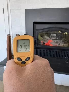

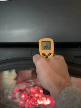

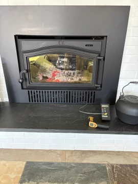

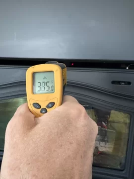

I have a Jotul C 550 V2 Rockland. Newly installed in December. I have only done a few burns but this week I have been burning since Saturday. I let it go cool overnight so that I could shovel out ash this morning. I started a fire around 9:30 AM and it is 1:00 PM now. Here's some pics and temps...
[Hearth.com] My Jotul is weak
Temp probe is at 438 F. I ramped it up to 1/2 open because it had cooled off quite a bit since I last checked. This is reading the thermocouple that Jotul provided with the stove.

Temp on RH face frame

Temp on LH face frame

Temp at top of face frame
View attachment 345670Temp probe is at 438 F. I ramped it up to 1/2 open because it had cooled off quite a bit since I last checked. This is reading the thermocouple that Jotul provided with the stove.

Where is that thermo couple. First time hearing of it. And what is it reading to ?

When my stove was delivered there was a cardboard box inside the firebox. The box contained a "catalyst temperature probe" attached to a wire with a two pronged plug at the end. It also contained a "catalyst temperature reader".
See your manual page 4 for contents of the box.
Jotul C550 V2 Manual Link -- Click Here
On page 10 of the manual it shows you where and how to install the "catalyst temperature probe" at the top of the firebox.
On page 18 it shows you how to connect and use the "catalyst temperature reader".

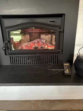

I reloaded the firebox around 3:15 PM today and here were my temps about 15 minutes later.
Thermocouple probe temp is 626 F.
