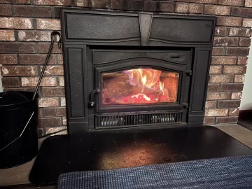

Although my Rockland is the older version, I’d imagine the basics are the same. I’ve used a IR thermometer in the past and it didn’t work well. It did not get a good read of the actual stovetop and instead picked up on the surround. I absolutely would not go by those IR temps. A stovetop thermometer from amazon will get to there before the weekend and they are not too expensive. This is where I put the stovetop thermometer seen in the pic below. For reference, I’m burning about a half load of pine with a little under half closed. The temp is about 675.
  • [Hearth.com] My Jotul is weak

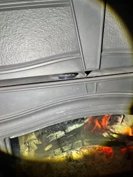

Tough to see, but it looks only half full.
Can't see how secondaries are either.
