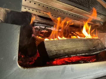

Tough to see, but it looks only half full.
Can't see how secondaries are either.
Ok I hadnt realized they reintroduced the Rockland. It looks like it is a normal tube stove so running it wide open will usually give you very low heat output because you are sending all the heat out the chimney. It will also give you the short burn times and seriously shorten the life of the stove. Do you have ceiling fans to push heat back down from the ceiling? Did they install a blockoff plate and insulation behind the insert if its on an outside wall?
Sorry. Just don’t know what “Secondaries “ are or where to look for them
It’s about 3/4 loaded. There is some room on the left side for a “short” piece but I just don’t cut 14” pieces too often. Most are 17’ to 20”
Seems to run better with some room for airflow. I may be way wrong with that statement
Ok I hadnt realized they reintroduced the Rockland. It looks like it is a normal tube stove so running it wide open will usually give you very low heat output because you are sending all the heat out the chimney. It will also give you the short burn times and seriously shorten the life of the stove. Do you have ceiling fans to push heat back down from the ceiling? Did they install a blockoff plate and insulation behind the insert if it’s on an outside wall?
Cieling fans are on but I can’t reverse the direction room is too tall, I’m too short and don’t have a ladder long enough.
Asked dealer about a block off plate and was told it will be too hot for unit. There is just some insulation surrounding the flue. I have to believe that is the culprit as the stone around the insert is warm. Almost too warm if it were just Sheetrock
Did you test with a moisture meter pressed deep in a room temp freshly split piece? what was the moisture content?
I won't believe the wood is at least not part of the problem until u verify this. As i see your burn with a good amount of splits shown in your pic....... i see smoke or steam at the ends and that fire should be ripping. It clearly is Not ripping.
Also there is bark on those splits which which usually means the splits could be dryer.
And i don't really see any secondary flames (Flames coming out of the tubes with holes in the top of the firebox). This also screams wood is not dry enough. There should be jets of flames firing out of those tubes, Just like a BBQ Burner.
Flames at the top are secondary flames

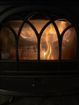

Is there anyone else in your area who can come and look at it? Maybe your installer/vendor didn’t give you the correct information.
They used compressed wood blocks though with the same result
I have loaded the entire box with “firebricks “
There is no possibility of them being “green” as they will blow up with the slightest moisture content. Much of the wood is 2 year old white oak annd ash that I was burning last year and NOT green. I have a pretty good working knowledge of “seasoned” wood. Some of the sticks are 2 year old stash. I have used some wood that was three year old. I do repairs for tree services in the area and have access to unlimited supply. Nothing in the stove atm is less than 12 months split and sitting. I don’t believe it’s the fuel. If it was there would be a day and night difference with the bricks compared to any of the firewoods

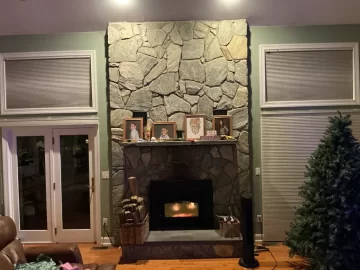

This sounds remeniscent of an old C550 thread. Help me catch up with a few questions.
@Angelo C Is this fireplace on an exterior wall? Was an insulated block-off plate installed up in the damper area? Is the insert connected to a 6" insulated, stainless liner? If yes, approx. how tall? If not, how is it vented?
(Excuse me if this was already asked and I missed it.)
It was answered and yes outside wall. No blockoff plate
Reactions: Angelo C
Thanks. Many years ago there was a lady who had a new C550 and complained of the same issue. She came to hearth.com seeking a replacement. We convinced her to have an insulated block-off plate installed and a layer of insulation added behind the insert. She was delighted with the results and went from wanting to replace the insert to loving it.
This doesn't answer the question of draft strength however. The air should be able to be closed down enough to promote good secondaries.
I can’t get the secondary to fire without full open vent. Work much better with door slightly open. Almost the opposite, as it is choking for air
