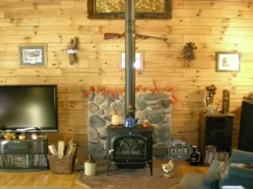

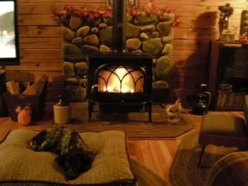

Sounds like my log cabin and roughly the same size.. I went for the Oslo and its been the best decision I've made for a while. You'd be upset if you found out the Castine was too small. We have a cathedral ceiling so I ran the pipe staight up to the roof. You get a good amount of added heat from the exposed pipe and it looks pretty cool too. I keep meaning to post some pics, as our stove is only about a month old and Im almost done with the cultured stone. I'll try to post pics on this thread in a bit. Good luck, its a great stove!

Heres our new Oslo.. just have to finish a mantel.
Really beautiful logger. Very nice job. Maybe we can all go to your house for pizza. Be safe.

colebrookman said:
Ed
Thanks Ed. We love the stove and so do our friends and family.
