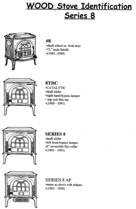

Yes, the catalytics are different and parts are getting scarce for them. Model 8AP usually refers to the non-cat. Is this for an 8TDIC?
From what I have read the model development order (oldest to newest) of the Jotul 8 is:+
#8
8TDIC
Series 8 (Cat)
Series 8 AP (Cat with ash pan)
I have tried for days to track down parts and it doesn't look good. Seems like these Series 8 might have been prone to overheating if operated incorrectly.
Sorry, I thought that with the 3 and 8 series that Jotul put a C in the model to designate catalytic. This was based on their literature on their site.

Trust me, you're better off. Those series 8 stoves were a painto work on and didn't hold up well. Yes I know, some have probably had great success with them, but mostly they were a nuisance. The older 8, like pre-catalytic was wonderful and smple to operate and maintain. Love them, may have one to sell soon actually.
It is certainly starting to look like this stove is scrap. I would love to try and convert it to a non cat but can't tell whether the same stove "body" will properly receive the burn plates of an older #8. Maybe its time to cut my losses and stick with the fireplace!
