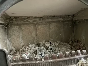

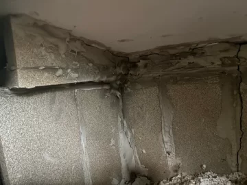

You have any pics of the new interior?

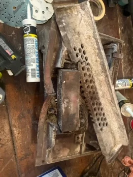

My apologies for the photo quality. I will be cleaning it and checking it with the top off. Will post more photos. I am using this to replace an AGA that burned propane. Would have kept the AGA if it was a wood burner. Was 20 + years old. Interesting to disassemble even though it was propane. The AGA shell is all cast iron. It is filled with loose vermiculite and then you get to the cast iron innards for the burner and ovens. Breaks down into manageable pieces. Unfortunately it was not convertible to wood.
First photo is the warped bits. Then the Vermiculite baffle. Side view and straight in the door.

Quick update. I decided to get some vermiculite refractory bricks and panels to line the firebox on this old Jotul 8 catalytic stove. Bricks are standing on end, 8" tall. I then cut two diagonally to create a support for the larger 1/2"vermiculite baffle which is at the top. Nothing that new here, this is similar to the much newer Hearthstone stove that I recently had.
Love working with vermiculite bricks. I cut them on my regular table saw. It was like a hot knife through butter.
Used retort cement to hold it all together. Did a small test fire to cure the cement after a day.
After a couple days, did a regular firing.
It seems to work well. Of course, it is not winter, but springtime in Maine is a lot like winter in some places. It works better than most stoves I have used that were of more recent manufacture.
The refractory is not as rugged as cast iron or firebrick but its low mass seems to allow the stove to get to operating temperature very quickly.
It is not as rugged as original but the refractory was inexpensive and everything looks good. The $40 Jotul 8 took about $150 worth of Ebay vermiculite and some retort cement to bring it back to life. And it lights off like a dream and throws out a lot of heat. Stack temps are about 250F.
