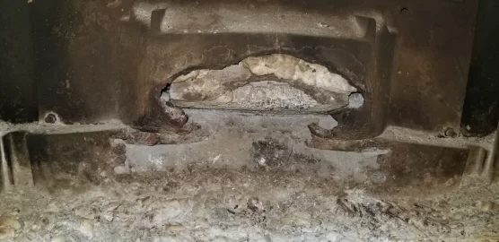

I bought a house with a couple Jotul stoves. Right now I am looking at the Series 8. This is what the back of the stove looks like. I am trying to figure out what parts these are. It doesn't look like any of the back plate parts I have seen. Can anyone tell me what this part is?

It's a dramatically burned out inner back panel. Some deferred maintenance for way too long.
