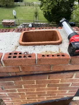

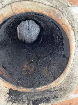

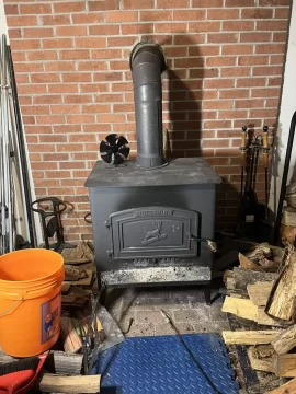

So I just called Woodstock and we touched on this. I really like them because they don't seem to hold back or sugar coat anything. So the placement for my stove is going into a basement that is halfway underground. It is a split foyer. He said that I would need to make certain that whatever I do I make certain my exit pipe is very well insulated or none of the new woodstoves are going to suite me well. The house is also between 1,500 and 2,000 square feet. Woodstock also told me there was no immediate rush on my decision. They said it is always possible that they get a bunch of pre-orders and have no availability but he told me I definitely have time to decide right now.
The wood stove that we have now has always done a nice job of heating the whole house, even on very very cold below zero nights with the wind blowing. That is something that I really want to and need to maintain with whatever I get new.
Sorry for the mess but this is what things look like now. Hope this helps you guys picture more of what is going on. IMG_2048.jpegIMG_2050.jpegIMG_2052.jpeg

Woodstock has good people and a good reputation. The market will heat up quickly and lead times for stoves and installers will greatly increase soon. The heating season has started in northern parts of the country.
Are the basement walls insulated?
Yes, my father insulated the basement when he finished it.

That's good. I'd get the chimney work and liner done asap. The stove can be hooked up later if desired.

Better clear this up first.
Straight shot through the wall? Through the ceiling?

Good idea, so in case you missed it you can refer to post #11 for a few pictures. So mine comes up off the current stove 2', then 90º into the wall, the space between the wall an chimney is just under 2' and the chimney then goes up about 17' from there. That is where I am planning a tee that will go up the rest of the 17' that will connect the rest of the stainless liner.
Yeah, I looked right at it and missed it. I suppose because I was paying more attention to what was written in that post.

Take note of rear clearances of any stove you consider. A heat shield behind the stove and stove pipe can reduce clearances even further, but in some instances, for whatever reasons, people may not want to install a heat shield behind the stove.
I only mention that because the Woodstock stoves may need slightly more clearance if I recall correctly. Just be aware this is something you may want to pay attention to.I don’t for see anything with that install, nut you never know.
