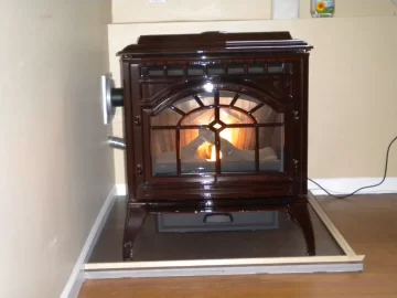

Tried to upload a photo - not sure if it worked.
  • [Hearth.com] Just got the new stove installed - Quad Mt. Vernon -  and have some questions...
It worked - your pic posted - enamel is beauteous! Can't see your stove plug-in end, but a surge protector is highly advised, even more-so if you live in a rural area prone to power surges, which can 'defibrillate' your sensitive (and expensive) control board slowly over time, or all at once if a nearby lightning strike picks off your house electronics. You get what you pay for in amt and degree of surge protection. Lots of prior posts on this issue.
