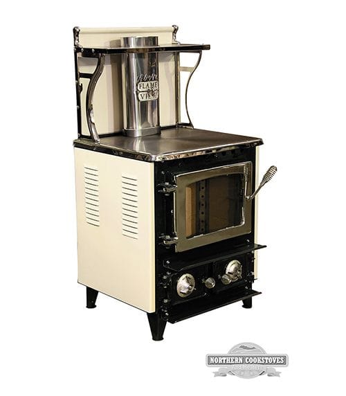

If it were me I’d do more research. The idea of a wood cookstove with oven would be appealing. The t5 is great but it’s not a cook stove. There are some larger ones available in the 2+ cu ft range I believe. Space utilization becomes and issue how we’re planning on cooking? I have my emergency cooking plans but I’m not sure I’d want to cook everything on a T5.
