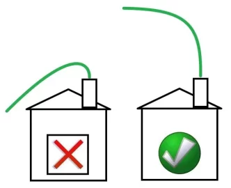

You need to get at least a full 10' above the chimney in order to feed the insulflex down. You will not be able to simply stand at the same height as the chimney and expect to be able to bend the liner down into the top. It has to be more of a straight shot, especially if you are going longer than 25'. See the attached picture for a visual.
