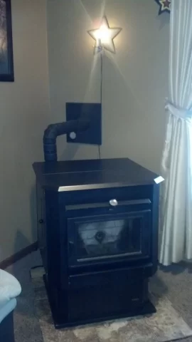

I used some Walker flex pipe (car exhaust stuff). Simple little oak in a corner. I couldn't find a thimble like that and didn't really mind another hole. That size pipe isn't easy to find either.
(broken image removed)
Thanks for the quick pic. That looks really good to me. What size Walker flex pipe is that?
Can't remember exactly - looking for the link I used to buy it... It's almost exactly the same as the intake pipe on the stove. To connect them I just used a piece of aluminum flashing rolled and stuck inside the intake - fits the ID of the flex pipe perfectly, tight friction fit. Ah, found it - Walker 36319:
http://www.amazon.com/dp/B001AGMRA4/ref=pe_175190_21431760_A_cs_sce_dp_1
Looks like its 1.5" ID
Thanks for the help again. How did you treat the outside? Is there a screen. Maybe I could conceal it in a dryer vent, or find a pipe that is 1.5 inches by like a foot long and push it through the wall and screen the end.
I used PVC - put a 45 deg. elbow on the outside pointed down and made a screen to go inside it out of 1/4" hardware cloth. The piece on the inside wall is a connector. That was the only funky bit. It was a little too small ID for the flex pipe so I had to rout about a sixteenth out of it to make it fit. Seems to work fine though - It never gets any ice on it, even in the sub-zero cold. 'Course it is right next to the exhaust which probably helps warm it up some. I guess I ought to paint it - it's a little rusty after last summer...
