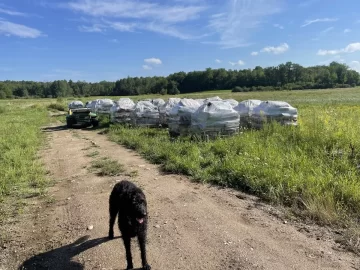

I am just south of johneh in northern NY and followed roughly the same schedule for over forty years with similar results. Ten years ago we installed a gassification boiler and, in spite of what most would have you believe, it functions best when wood is in the 15% range, the 18%-20% doesn't make it. So I began to experiment with "kiln drying". This will be my fourth year and I think I have the process down. We split right onto pallets in early spring out in an open, windy field and then in June top cover and shrink wrap with vent holes near the top. When we unwrap the 1st pallet in the woodshed in early November, the primarily hickory and sugar maple are at 12%-14%, any cherry is down to 10%-12%. With 1/2 cord per pallet, 20-24 pallets will get us through the winter in good shape. As the pic shows, I managed to get a bit ahead this year with a total of 38 pallets, but only wrapped 24.
Very telling info for those using a gassification boiler. Really makes one wonder what many operators are missing out on for performance. I know it makes a huge difference in a standard freestanding stove.
If you could. A few closeup pics of your assembled pallet/top cover and wrap would likely help guys out.
Do you put anything water proof on the pallets first? I tried a few different versions of your method and had varying success keeping the wrap on. To much wind.
