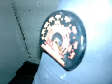

This evening, I re-loaded the stove with 4 large splits of poplar onto a med. bed of coals.
Closed the door, turned up the draft and set the egg timer for 10 minutes. 8 minutes passes and I go check on the stove, even though the timer hasn't gone off yet.
Stack thermo showed about 250 degrees F when I re-loaded, stove top was about 350 F.
This is what I saw when I returned...

My apologies for the poor quality photo, but you get the idea. Stove top temp crept up to 500 in that time.
This happens every now and again. No big deal, it just goes to show how quick those temps can climb.
500 is a typical temp on my stove, since I have triple wall class a chimney, I have no idea how hot it is.
To keep mine on the cooler side, I installed an optional blower fan. No longer does it creep up in the 700 range.
Since the pic is so blurry, I should mention that the needle is pointing to what would be about 900 F, if the guage was marked that high.
It is probably benificial to briefly run those stack temps to keep the chimney clean.
BTW, I turned out the lights to look for glowing sections on the stovepipe, and didn't see any....:)

well, 900 is a different story. good idea turning out the lights and checking things out.
I would think you have a very clean chimney now.
