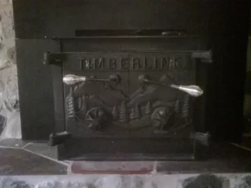

I have been using the "search" function / lurking for several months now. Attached is a photo of the beast I'm replacing.
I just noticed today, coincidentally from a photo of yours Lanning, that the fan controls are on the right side which will be in plain view of anyone entering our house. My wife mentioned that before, but it went in one ear and out the other until I saw that photo. She also said she did not want to see a cord. Period. It looks like I would have to tuck the fan cord under the unit and at least an inch of cord would be showing. Plus she would like to reclaim some of the hearth that the stove sits on. The BK measurements indicate it sits out 13.25 inches from the facia. That is about as much as my Timberline.
All in all, I think all the little things add up to the C260 even though I kind of want the BK. I'm sure I'll be happy with either.
