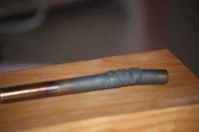

I may have found my problem. Look at the pic.
My ignitor is bent and all built up with ???????
It is like it just got so hot it melted in the spot.
Id say it shorted out.
