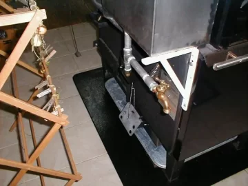

How many square feet are you heating? There are two sizes of the Kitchen Queen.
Here's the larger 480 that heats up to 3000 sf.
If you search posts by me containing "Kitchen Queen" you'll find plenty more as well as the thermostat I added.
Another new cook stove to check out is the Grand, by Grand Stove Co. It is a very close copy to the Nectre Stove from Australia called Vermont Bun Baker in the US. Available from Obidiah's, Lehmans, or the LLC holder Ed himself at Antiquestoves.com. (small at approx. 700 sf heating) The lids are identical to the Queen but smaller, and the holes punched in the sides are identical to the Queen, so it may be built at Duane's shop, the owner of the Queen. They are advertised "Amish built" and a Amish owner would never use his religion in a business name or advertisement, so Ed being the liaison to the Amish can do that with them building it for him.

Careful when you add the thermostat under grate. If you add up the 3 intake holes in the stock intake through door, you get 5.29 square inches. DO NOT make your intake larger, you will be over firing. I keep the stock air inlet open a touch to admit air above the fire all the time as well. The thermostat isn't needed to control heat on and off as much as a safety that closes when you get busy or gives it a shot of air like the supercharger. I have not used the supercharger since adding the T-stat.
