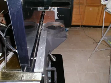

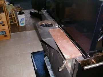

I leave the top lids on all the time to allow enough moisture out of the vents in the corners of the lids. If it gets too dry in the house, I remove the lid away from the firebox side and if more water vapor is needed, I remove the lid on the firebox side. I've never had to remove both at the same time.
I also added 1/2 inch aluminum heat sink under the tank to increase contact area of stove top to water tank.
Partly because I already had the material and we use quite a bit of hot water from the faucet I added.

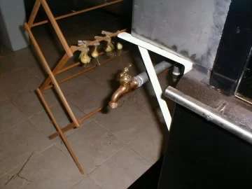

[Hearth.com] Kitchen Queen Water Reservoir They are onions drying on the clothes rack behind it, and notice the shelf bracket I added to stabilize the tank on the stove back as well. Your tank will be smaller and probably wouldn't need it. The center of tank sets on stove top around exhaust vent, but has little support on the ends. It also was to make space fro hanging stove tools on the back. My stove is in the middle of kitchen.
View attachment 215668 View attachment 215669
View attachment 215670 They are onions drying on the clothes rack behind it, and notice the shelf bracket I added to stabilize the tank on the stove back as well. Your tank will be smaller and probably wouldn't need it. The center of tank sets on stove top around exhaust vent, but has little support on the ends. It also was to make space fro hanging stove tools on the back. My stove is in the middle of kitchen.
