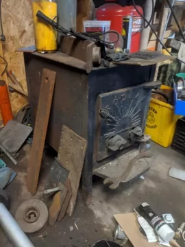

I'm looking for some info on this stove I was looking to purchase for my new garage build .
It's a 24x32 garage with 10' ceiling
I'm looking at this Kodiak stove but don't know the model or BTU output .
Could anyone help me out ?
Thanks
Ernie

No idea of the model or btu rating but unless it is well insulated I would go bigger.
And you should know that wood burners are not allowed in any garage by code in the USA.
