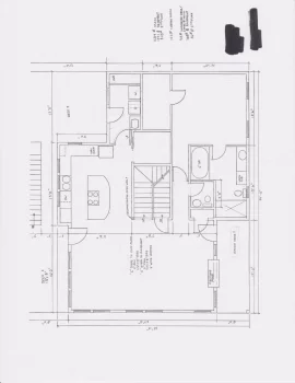

We're building a new home in Ashe County, NC, not far from Boone, and want to confirm that the Kozy Heat will be a good choice for us. After spending hours on this fine website exploring and researching, I feel like we're headed in the right direction at least.
Our purpose for wanting an EPA certified ZC wood burning fireplace insert: both my husband and I grew up in CT with wood-burning masonry fireplaces (plus, my dad had a wood burning stove next to the oil furnace that rerouted all the water through it, with the furnace only coming on when needed... currently, we are not prepared to take on that level of wood heating/wood requirement!). Our current home has a ventless gas FP that we used about 8 times when we first moved here in 2000, and not since because we dislike it. We want 1) a FP that will provide the ambience of a wood burning fire 2) to be more efficient in terms of amount of wood used and environmental impact 3) a FP that will actually put heat into the room instead of draw it out. The builder was going to put in a builder grade Bungalow ZC unit, but after research, we discovered we really didn't want that. At first, I looked at FP inserts but after a bit realized they were for existing masonry fireplaces. Unfortunately, we are now at the point where our builder needs to know FP specs by early next week.
Our concerns: 1)That it will make the room too hot. After reading some of the many posts here of 80* rooms with windows open, I worry about being able to sit in the fireplace area and socialize/watch TV/etc. 2) That guests who use the house could mess something up.
The specifics of the house:
Floor plan posted below. The main floor where there fireplace will be located is 1300 sq ft, with the LR, DR, Kitchen in an open floor plan, the kitchen being at a right angle to the dining room area. The bedroom is down a hallway which is close to the location of the fireplace. An open (to one side, the side away from the FP open to the kitchen) staircase leads to the 800 sq ft upstairs, to a hallway with one small bedroom to the left and a master suite to the right. The stairwell is 17' high. These are not located above the LR/DR area, but over the kitchen/BR. The ceiling in the LR/DR is a shed ceiling starting at 9' and rising to about 13 feet. There will be ceiling fan in the middle of the room. The fireplace is located on an exterior south facing wall, at a point where the ceiling is about 11 feet high.
Location: on a windy hillside with great views. The lot is treeless (nothing to impede the 270* views) but after viewing this site I now interpret as no source for free wood :). It's at 3100 ft elevation. In the winter it can get quite cold for NC standards... in the teens with below zero wind chills. It can just as soon be 40-50* or more in January.
Heating/Cooling considerations:
Electric heat. Only options were propane or electric. As you can see from the floor plan, there are lots of windows. These are all standard height, high quality, insulated windows which are rated for high winds. 2x6 Construction which will have blown-in insulation. I have no idea what the heat demand is, but with the square footage of 2100 at and above the FP level, and another heated 800 sf in the basement, our load is requiring one heat pump. We are not looking at the FP insert as the primary source of heat, though I guess it would be wonderful if it can cut the heating costs without blasting us out of the room.

Thank you for this advice! I will need to ask if a heat loss calculation was done. Here is what our contract says as for insulation: "Provide insulation that meets or exceeds local building codes. Insulation shall be provided in bedroom and bathroom walls also. Exterior walls = R-23, Floor= R-19, Ceiling=R-38. Upgraded insulation in the wall (optima blow-in)." Windows: Hurd with insulating double pane low E, argon filled. Other entrance doors shall be steel 6 panel doors.
The construction is 2x6, with log siding and sheet rock. Roof is sheathed with 5/8" OSB, titanium roofing paper, and metal roofing. HVAC is an electric heat pump system with air conditioning. Everything is built to withstand high wind, as we are in a "high wind area." I know that still doesn't answer the heat loss calculation question, but does it say anything to you? Are there any ZC fireplaces that aren't actually stoves, but that provide some heat without causing heat loss?
I feel rather stupid that it has gotten this late in the process and I still don't know what I'm doing. I would, however, want to be on the side of having too much heat from less wood than losing heat with a lot of wood! Oddly, I don't remember the two story masonry fireplace in my childhood - college home feeling drafty or cold away from the hearth. My dad did install a blower in it, so I guess it must not have had any efficiency before that. All I remember is the wonder of having a fire, adding wood to it, rearranging the logs, etc. Somewhere here I read that the emotional pull of a FP is one of the main reasons people decide to go that route.
I am so thankful for this site, but it seems the more I read, the more confused I get!
The insulation sounds average for new construction. What is the make/model and specification (heating capacity) for the heat pump?
It looks like the Kozy will do the job ok. It will be up to you to burn smaller fires during milder weather. In the dead of winter you probably will be able to burn a steady fire all day. One advantage here would be to duct some of the heat to the room to the right of the bathroom. That would help even out the warmth.
However, if you mostly want the fireplace for ambiance then go a bit smaller with the 2 cu ft BIS Tradition CE (same as Lennox Montecito) or an RSF Topaz. A less expensive and more flexible alternative would be to install a nice looking freestanding stove on a beautiful hearth. For ideas there are some shots of each in the gallery section. https://www.hearth.com/gall/main.php

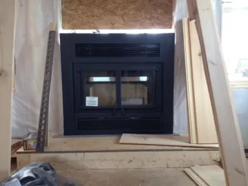

Those aren't the requested pictures, but I couldn't resist. I'll have the first photos of the framing taken this weekend. Thanks again for all your help, everyone!

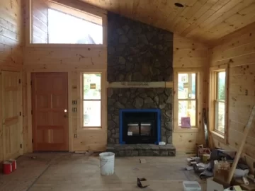

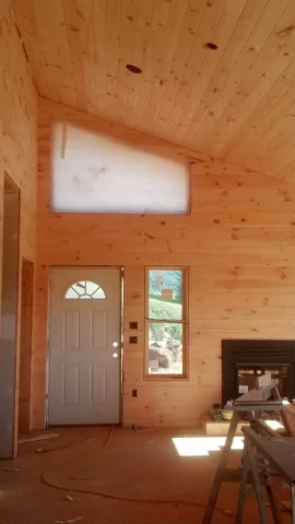

Our house is FINALLY nearing completion, hope to get the CO by the end of the month. Here's an short picture history of the Kozy Heat z24 so far. Even though I know it's zero clearance and made to be installed in wood, it still seems very odd to me. It's a bit scary, but I guess we'll get used to it. The mantle is still being made. I'll let you all know how the first burn goes and provide more pictures.

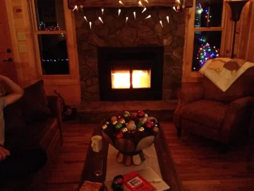

Here it is: the first burn! Working great so far. We still have to figure some things out, but so far, so good. Haven't burned it hot enough to ignite the secondaries, but it's still heating the main floor and upstairs nicely. Thanks for all the help provided through this website! Hope you all had a good Christmas. Best wishes for a marvelous 2015!

Thanks for the update. It finished out nicely.
I suspect you are already getting secondary burning, but maybe giving the fire too much air? When burning after a reload, turn down the air once the fire is burning well until the flames start to get lazy. Let the fire regain steam, then turn it down again until the flames get lazy. That should encourage strong secondary burning.

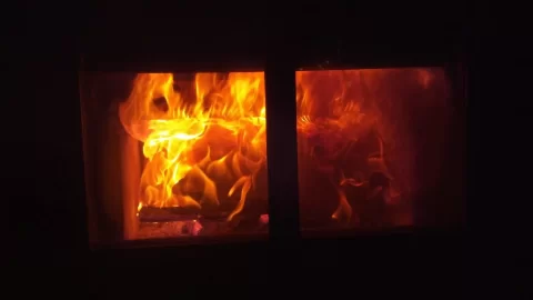

Thanks, begreen! Followed your advice and the result is below. Really neat! The one window is a little sooty, but it ended up burning clean, as did all the bricks… not a trace of soot anywhere. There wasn't much to begin with, but I guess it's all part of the learning curve.

That's the idea. Secondary combustion increases once the fire is hot and the primary air is reduced. Looks like a big full blaze. You may be opening windows soon. :)
