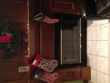

My wife and I purchased a new home last month. The house has a wood burning factory fireplace installed in it (Heatilator EC42).
I fired it up last week and as far as I'm concerned it's complete junk. Only good for ambience. I does not have a blower unit installed, but something tells me it wouldn't help much. Is this a correct observance?
I need a solution that can actually heat my 2000ft. home.
It's my understanding that I can't put an insert into this unit as it could be dangerous, so I'm thinking of ripping it out and installing a Kozyheat Z42 zero clearance fireplace.
Any thoughts or suggestions?
I think I will have to run a new chimney liner down the double wall pipe since that probably won't take the heat.
Thanks for any ideas.
