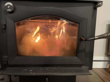

Can you post a pic of how you load your stove? A shot of the wood in the firebox. Maybe you have too much space between the splits or the splits are very small?
Yeah I was thinking about that the other night on my way home from work and forgot to post that…. I believe it’s two 45’s. Usually I lay 4 larger logs north to south at the bottom with 2 or so smaller logs or kindling on top to get things started. For reloads, I let the cat temp come back to the hashed zone and then break up the coals and place two large logs north to south on top the bed of coals. Poor quality picture attached as I forgot to take one before I lit it but I’ll try again later today.

I am a bit late to the party but wanted to chime in. Just bought the insert version of your stove about a month ago and love the heat it puts out. 16’ stack I am getting 10+ active cat hrs. I get all of the wood nice and charred and when the front secondaries come on, I close til there is about 3 inches of air control left. In 5 mins it climbs and you see everything turning red, I close air control to about one inch. Pictured below is last nights load two ash blocks/splits with one large locust round and an oak slab on top. Loaded at 830pm last night and reloaded this morning at 610 am. Didn’t even think to take a pic of coals this morning. I pack it tight to burn all evening. If you think things are getting too hot, turn the blower on high. Did I notice in your picture you don’t have a fan on the stove? Maybe some others can chime in on ceiling fans but I also run a floor box fan into the stove room. Pushing cool air in displaces the hot air. I keep my stove fan on low 90% of the time but when I see the secondaries really ripping, I crank it up to high. How much have you played with your air control? These are great stoves!
