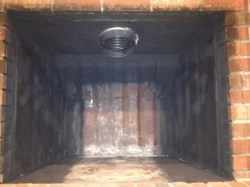

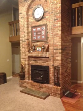

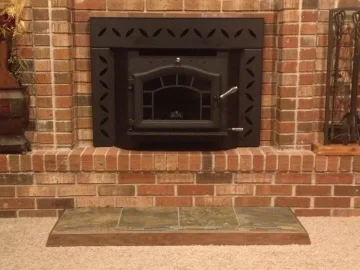

I saw that someone had posted some questions about the Kuma Sequoia in the last couple of days, so I decided to post some pictures and give a brief summary of my install experience from this past fall. This is my first insert, and I found this website to be extremely helpful throughout the process. In addition, we did not have a local dealer at the time of my purchase, so the Freeman family of Kuma very patiently answered all of my questions. Kuma really seems like an excellent American family-oriented company.

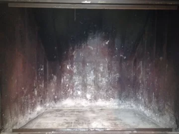

We have about a 3,500 sq. ft. two story home in southwest Missouri with a centrally located brick fireplace in a vaulted living room. I installed two 68" ceiling fans to help move air around better, and I did not purchase the optional fan for the insert because I was hoping to have less noise. We had a heatform type metal firebox liner that I had to greatly alter using a grinder (slow, noisy, and dirty, but eventually successful). I purchased the 8" chimney liner from Fireside Chimney Supply and installed it (no pictures because I had my hands full trying to not die). I placed Roxul insulation just below the chimney top as well as above the block off plate I made from a piece of sheet metal. I used an appliance dolly with moving blankets, a furniture dolly, a motorcycle jack, a roll bar, a sheet metal slide, and some friends to move the insert from my garage to the inside of the fireplace. We decided to cut the surround down and make a decoration in it. We did this partly because my wife didn't like that much brick covered or the solid black appearance. We also thought there might be just a tiny bit of heat that was be available to come through the holes in the surround. Finally, I wanted to be able to see the catalytic thermometer that is normally hidden behind the surround. I used my jigsaw and electric drill to cut down the surround and make the little holes all over it. I then used the paint they recommended to repaint the surround. I made a slate hearth pad to get the 18" protection in front of the insert. I converted my fireplace toolkit broom into an ash rake, and I made a rolling woodbox out of some cedar.

What a great job with that surround! Kuma should offer it as a regular option.
Love that brick chimney/fireplace. You pretty much have a masonry heater there now.

That came out really nice. Great job!

Looks great!
I usually an not a brick fan(have it here and hate it), but your brickwork is truly beautiful!
Enjoy that beast of a heater.
Reactions: warbonnet and Judd
That's one helluva a stove in one helluva hearth. It looks fantastic. Thanks for the report.

Judd, great install. I was the one looking for Sequoia updates. Glad that you have it up and running. I am looking forward to seeing one at the dealer in a few weeks. Thanks for acknowledging the help from the Freeman family, I will be contacting them.

That is some sweet setup. Nice, very nice and I love that big ol hunk of stove too.

Beautiful.
Loves me a big honkin steel stove.

The surround panel modification is impressive, and the big brick hearth is very cool. Any questions at all make sure and send a message thru our contact form on the website. Jack, who handles those emails, uses a Sequoia too.

Thank you, Jason. My wife was happy with how the surround turned out, and I was relieved that I didn't have to turn around and order another surround after butchering the first one (although my little craftsman jigsaw bit the dust half way through the project and had to be replaced). Jack was extremely helpful through the entire purchase process, and I even have a question into him through your website right now. You guys have been great.
It would make a great brochure beauty shot, but you may get people asking for that decorative surround.

I can't get over how cool that fireplace is. Next time we need photos for a brochure I'll be checking in with ya.

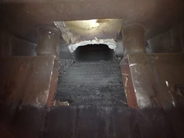

Missed this thread previously. Great-looking install, and nice to have one in the field that we can get some feedback on next season (hint,hint.) ==c I'm curious as to what the actual usable firebox size is? In lieu of measurements, a couple of pics would be nice. The Buck 91 claims 4+ cu.ft. but it's more like 3, usable; The height from the floor of the box to the cat shield is probably around 12".

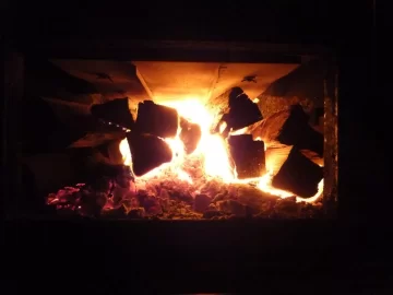

Thank you. Attached is a picture of the inside of the firebox. I know you didn't ask for measurements, but I'll add them just in case anyone else would like to know. It is 24" wide. The height from the firebrick floor to the bottom of the catalyst shield is 12". The depth is a little variable depending on where you consider the front, but I would say it is 18" of usable space with an extra 1.5" or so to the actual glass. Based on these measurements, I would consider the actual real world usable volume to be about 3 cubic feet (it is listed on their website as 3.6 cubic feet, which I am sure is accurate if you are counting the entire firebox...both usable and unusable). There is a little space on each side of the catalyst at the top that increases the usable space some (and I do use it when I'm really loading it), but conversely there is also a tiny amount of space that us cut off at a 45 degree angle in each corner of the box that would decrease the volume about the same amount, so the 3 cubic feet is probably pretty close. As I understand it, it is not unusual for manufacturers to list the absolute largest possible way of measuring their firebox, and probably since they all do it, it is accurate in a relative sense.

Appears that the box is a little taller than the Buck's. The Buck is lined on the lower sides with firebricks standing on end, so that takes away a little room. Like you said, I can also get a couple of small splits in the top, beside the cat shield. Looks like you may be able to gently dust the front of the cat through the holes, without removing the baffle, maybe with a small artist's paint brush and gently blow some canned air through the cat (no compressed air!) I pretty much have to take the cat shield off to get good access to the cat on the Buck.
