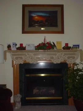

Hello ,
Been lurking here a few weeks and need some options on wood burning zero clearence fireplaces.  Currently we have a Majestic DV360 RFN direct vent gas log fireplace. The gas fireplace sits in a corner that measures 76" across.    The RSF Onyx and Napoleon 26 would fit as well as the BIS Ultima. Is there a medium sized unit that is heads and tails better than the others?    I see some of these units can only use their brand of pipe which can make the cost add up fast, what are your experiences, thoughts?                                                                                                                                          This is a great site, Thanks

You are looking at good brands. Maybe look at KozyHeat too. Yes, this will be a complete tearout and replacement and will be pricey. If you could add a woodstove elsewhere and leave the gas unit alone, that might work as a less expensive alternative.
Mo - just to clarify, you can't yank the gas unit and just slam in a wood unit. It needs a stack designed for wood (and hearth, etc.) If this is obvious to you, I apologize ahead of time.
