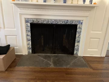

I have an old large masonry fireplace (Front opening dimensions 50" Wide X 36" Tall (slightly shorter at the back of the fireplace) X 25" Deep). I'm in the process of doing a bunch of insulation and air-sealing to make the house more energy-efficient and I am a bit at a loss as to the best way to handle such a large fireplace while preserving as much character as possible.
My main goals:
  • Ability to have fires in this room without worrying about huge amounts of conditioned air running out of the house
  • Keeping the existing tile & mantel
  • Large fire "viewing area" for ambience
I am looking for more heat output efficiency than a standard open fireplace, but this fireplace is not meant to be a significant source of heat for the home. (I am converting a smaller fireplace in the home to a Blaze King Ashford 25 for that purpose)
I have some different options and I'd love input. Willing to invest a good amount of money for this project so budget is not the primary consideration.
1) Attempt to make current fireplace more "efficient" (although I'm well-aware that this efficiency won't get anywhere close to an insert or stove)
I would install some combination of:
  • air-sealed pyro ceramic doors with a bottom damper (from Stoll)
  • outdoor combustion air kit
  • catalyst
Would this accomplish anything? My hope would be the combination of the doors and outdoor air would allow me to reduce the amount of conditioned air sucked up the chimney, but my hunch is from reading through other posts on this forum that this might be a doomed avenue.
2) Install an Insert
Is there any option for an "interior install" that wouldn't damage/alter the tile? Are there any inserts large enough such that there wouldn't be a large gap to fill around the insert? (Or is there a more attractive option to fill this gap than the plain black steel border?) The fireplace is so large I am having a hard time envisioning how the smaller inserts would look.
3) Install a stove in the fireplace
I don't see this option pursued that often - are there any important considerations to keep in mind? My hope here would be to get as large of a stove as possible with a large window to maintain ambience.
Thanks in advance for all input!

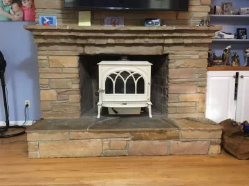

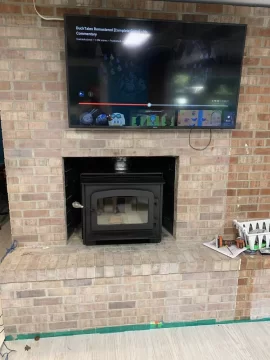

We had two open fireplaces one with the white stove is 42”wx29h. The one with the insert is 36”wx28”h.
I really like the stove inside a fireplace look. It heats good enough for us. I don’t care for a large surround. I may try to install a surround inside my brick opening for the insert but I think I will try to conceal the liner. With some black stove pipe or similar.
Doors are just a way to keep kids out of the fireplace I found;) We got rid of them after 5 or six fires. Just was too much smoke In the house. Draft was fine I’m just pretty sensitive.
At 36” high you have more choices than I did for stoves.
Mantle clearances could/will be an issue. Stove or insert. I think a pacifier energy T5 could look very nice but I’m not sure how to fill all the space. Or if it even needs to be to look good. Mantle clearance will dictate choices I believe.

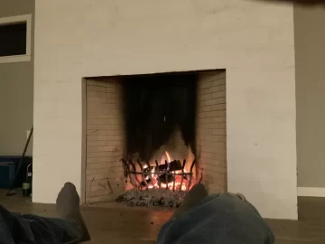

You need to make it into a retrofit rumford fireplace.
Look on Rumford.com website on the plans for those units.
Anyone who say a fireplace can’t heat a house has never owned a Rumford.
I am sitting in front of my 60”x54” Rumford that I built 4 years ago and it’s my only source of heat currently. It is keeping my 4200 foot house in the high 60’s this week in wisconsin. Last winter I wanted to test it out and it kept the house in the low 60’s when the outside air was 15 degrees for a week solid. It was the only heat source running. It does like wood though but then again most large houses do. This fireplace will heat a wall up that is 52 feet away to over 80 degrees according to my laser thermometer. It will heat my leather couch up to 120 and it’s over 10 feet away.
The make up air currently is just a slightly open window next to the fireplace and rest of the house warms up nicely.

Rumfords are about the best fireplace design around the only thing better is a prior fire. But they are still really far behind a woodstove even old ones. Modern woodstoves are vastly better in every way.
Yes one could spend a huge ammout of money to modify their fireplace into a Rumford to maybe get to 50% and still burn pretty dirty. Or you could spend half the money and install an insert or stove.

From what you have said that heat really isn’t all that important why are you pushing for more efficiency?
View attachment 284197 View attachment 284198
