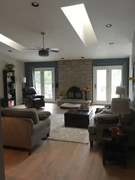

Our house was built using Insulated Concrete Forms (ICF). It's a large ranch (main floor is 2,800sq ft, so say 5,000ish with finished basement). After a year or so of research and living in the house longer, I am definitely going with an insert on the main level. It will go in our open living room that measures 19' x 22', with vaulted ceilings. I've attached a pic of the living room and a rough drawing of the floor plan.

Reduce propane use as much as possible. We go thru about 700g Sept – Feb. (200g a mth when it's REALLY cold) of propane. Another member originally mentioned that those kind of numbers would call for a medium sized firebox, something in the 2 - 2.5 cu ft range. *However, everyone always says to go larger if you can. Whataya' guys think? Should, or could we go with a large (3+ cu ft) firebox and not get burned out of the main living area.

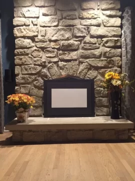

So I built a rough "replica" of the Osburn 2400 out of black foam core to get a better idea of what the stove would look like. We're not fans of how it looks extended onto the hearth - so we're going flush instead of semi-flush. The Mrs wants a larger viewing area also. She likes the Large Flush Hybrid Insert. I'm not familiar with the Hybrid technology. Looks like I'll be searching the forums a little more.

Need a little help on what it would take to get the LFI to fit (if it will at all)...
Setup another foam core replica (pic attached). It's kind of hard to see in the pic, but there are three pieces. The largest/outer black piece represents the Metropolitan face with beveled edges (35 3/8"w x 26 1/4" h), the inner black piece represents the insert (31"w x 22" h) and the white piece is the glass.
Our Fireplace Measurements:
Front Width: 36"
Height: 27.5" (at top of arch)
Back Width: 30.5"
Depth: 24"
The LFI Minimum Fireplace Requirements Are:
Front Width: 33"
Height: 23.5"
Back Width: 20.75""
Depth: 19"
Comparing numbers, it's look like it would fit no problem. But with the way the arch width tapers, I think we might need to chip away some of the stone to get it to fit. There's no going back if we do that. Is that normal - or better yet, a big deal?
