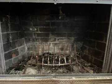

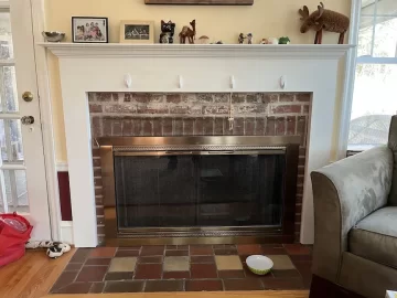

Hi - I'm looking at inserts to convert an existing masonry fireplace (49"w 26.5"h x 24"d) for our 1920s stone colonial. The main-floor living space is about 500 sq. ft and relatively open, with about the same space on the second floor and a ~300 sq. ft bedroom over the garage. My goal is to enjoy the fire and get some main-floor heat during the cold months, but not necessarily to replace a big chunk of our heating. I assume the over-the-garage bedroom won't get that much heat, and even the 2nd floor may be a little marginal - we have hot-water heat (radiators) and so not much ductwork (although there are a few small ducts for a retrofit central A/C system). The second floor should get some heat up the open central stairwell, though, and we have a couple of ceiling fans on the main floor that could move some of the heat.
There's a local Regency dealer, so I've been looking at the Regency Cascades i1500 (1.3 cu ft) and i2500 (2.3 cu ft). I'm inclined toward the i2500, to have a bigger view of the fire, and to have more of the fireplace filled with the insert vs. just covered with backing. My main question is, will the heat from a unit that size overwhelm the main-floor living space? I don't have a lot of experience with stoves and inserts, but have tried to do my homework. It seems like we would want to build a decent-sized fire to get up to a temp where we aren't burning too cool and dirty. But once the fire is going and the unit is up to temp, I don't have a very clear sense of how much we can then control the heat flow through the room.
Thanks for any thoughts!

I think you’d be better served with the larger insert, but I do have a couple of quick questions.
1) How high are your ceilings? If taller (or shorter) than the standard eight feet, that needs to be taken into account.
2).Are you able to draw a quick sketch of the floorplan, marking the location of the fireplace and the width of doorways and stairway?
3) How is your wood supply?
Reactions: AstroBoy
