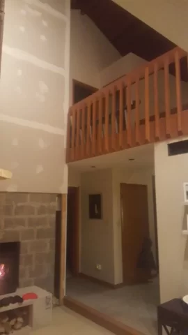

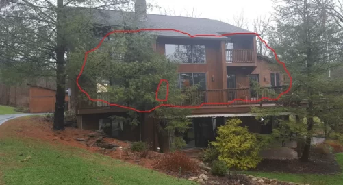

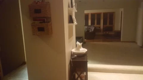

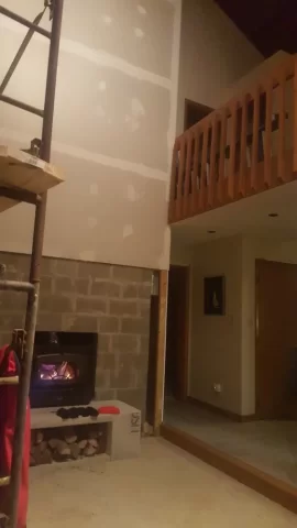

I know this is always open to opinion but I am open to all opinions at this point. I currently have an Appalachian 52 bay insert and we are trying to heat a 2700 SQ FT very open area with lots of windows and sliding glass doors and 25 foot ceilings in the room with the insert in it. When the temperature outside gets below the mid 30s this stove won't raise the temperature more than 2 degrees in the same room the insert is in (my thermostat is 15 feet in front of the insert) and when it is in the 20's outside the insert will only hold the area to temperature. It is looking like the current insert is way too small for us to use to reliably heat this area of our house with. Does anyone have any advice or experience with similar situations? I have attached a couple of pictures of the house and area to help with perspective. In the outside picture I circled the area I am looking to heat and the small circle is where the insert is located and the last picture is looking from the insert towards the rest of the house. I would like to know if there is any inserts out there that would produce enough heat to heat this area?

Looks like there would be lots of heat loss with all that glass. Have you ever taken the temperature at the peak of that 25ft ceiling when the insert had been running strong for several hours?
Hi Guys thanks for all the reply's so far. Let me clarify a little bit. There are only 25' ceilings in the room with the insert in it and it connects to bedrooms upstairs via that walkway in the picture. I haven't measured but the 25' ceilings are only in a room that is about 300 sq ft not the whole area if that changes anything. The rest of the house has normal 8' ceilings.
Begreen I have taken the temperature at the peak of the 25ft and it was only a few degrees warmer than the ground temperature, that is why so far I haven't found it necessary to install a ceiling fan up there. I have thought about the ceiling fan up in the 25ft peek to push the heat down but at this point I'm not seeing the temperature up there high enough to justify that.
The Bay 52 is going to struggle to heat that area inside the fireplace, as others have said you need to ditch the insert idea and either put legs on that bay 52 and use it as a freestander (it is rated for insert OR free standing) or buy a larger free standing stove and install a thimble/crock into that masonry so you can use your existing flex liner. As others have mentioned you want a firebox in the 3+ range for that much sq footage.
