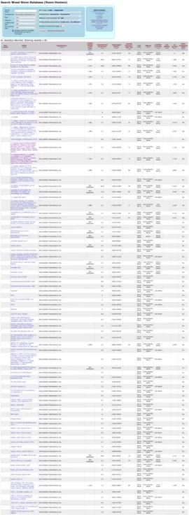

That was a search of EPA Burnwise, but included out of production models. You can find a lot of stoves that may fit your needs.
Here's a clip of the 2020 stoves available now, but doesn't show all since you can't scroll down on the clip.
