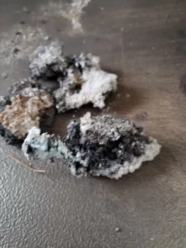

I was cleaning my insert this morning and found a couple of pieces that looked like lava rock. Very light and airy. Sounded almost metal when the shovel hit them. Any idea what this is from?
Happy Thanksgiving!
Could be clinkers. Happens with some wood or bark. Mineral remains after burning the wood fuses together into this.
It's normal - for some types of wood. Nothing to worry about.
Yup, its specific to wood species, stove or boiler configuration and how its run.
I've had more and bigger clinkers this year... like 1 1/2"×6"×8" sheets of it! Been burning some punky honey locust during the day - almost has to be from it. Was a yard tree someone gave me. I seem to get more clinkers from "yard" tree's versus "woods" tree's.

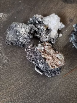

Found some of this last night. Had a large piece stuck to the bottom of the stove and had to pry it up.. It broke into some smaller pieces. I also thought it was metal. I've been burning some of my odds and ends 24/7 and haven't cleaned the ashes out for a few days. I've been scraping the coals and ashes to a pile in the front before a relight.
