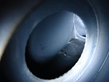

I used my leaf vacuum several times last winter and once just before the big spring cleaning. This is a picture of the inside of the blower housing, you can see only one small pile of ash in the corner that the vacuum didn't draw out. This was after one ton burned.

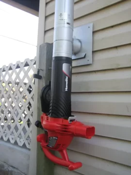

Is that attachment you have connected to the metal an add on? The one I see online doesn't look the same.
http://www.homedepot.com/p/Toro-Ult...-12-Amp-Blower-Vacuum-Mulcher-51619/205746070[/QUO
this is the one I have....http://www.cpsc.gov/en/Recalls/2015/Homelite-Recalls-Electric-Blower-Vacuums/
as u can see, there was a recall as the unit can overheat and sparks can ignite the leaves and catch fire.
I still use it as I'm not sucking up piles of leaves with it..
