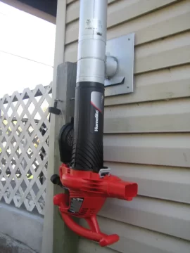

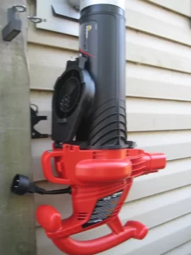

A little less work if you get one that fits right on like this home depot homelite model... very cheap.
  • [Hearth.com] Leaf blower?
