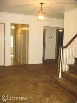

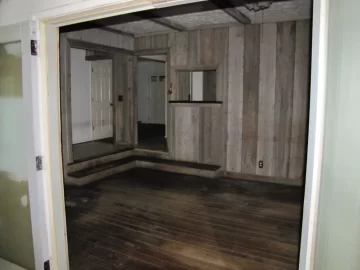

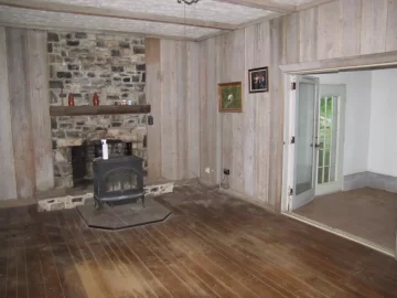

First picture is standing in the foyer looking towards the room that has the fireplace in it. The really dark room to the right.
Second picture is self explanatory :)
Third picture is standing in an addition they did (I think its supposed to be like a sunroom without enough windows?) looking thru the family room back to the foyer.

EDIT: I posted a reply BEFORE seeing the pix. Definitely looks to be a Site-Built Fire Place. You probably won't need to insulate the entire length, but you'll need a block off plate at the bottom of the liner & insulation at the top.
fireplace is definitely site-built. the sellers took the wood burning stove with them when they left, and relined it and installed the top damper because of a contract prior to mine. that contract fell thru, so I got the leftovers. the new liner for the chimney was apparently not a normal size because the chimney flue was so big (I am talking about something I know nothing about, if it doesnt make sense its probably because I got it wrong).

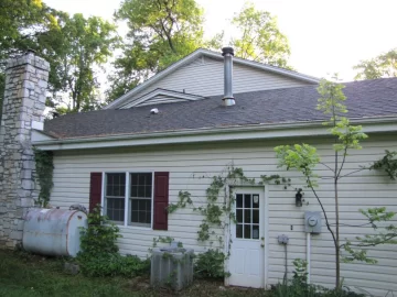

here is a pic of the exterior if it helps. Can I put a liner inside a liner?

Yep. No problem doing that. Can you post a pic of what that liner looks like where it enters the fire place?
you mean the fireplace looking up into the chimney? Don't have a pic of that, can take one tonight though...

All modern inserts/stoves need a flue size that matches the unit to burn properly. Since it is an exterior chimney I would consider an insulated liner of the correct size for the insert you decide on. Add a block-off plate at the bottom and the cap that comes with the kit and you will be good to go. Since your current flue is so large it should be a fairly easy DIY install.
