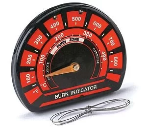

Got a new thermo for Christmas and am very happy with it. "Porcelain enamel-coated steel housing with an easy-to-read dial that indicates the optimum burn zone". Liked the manufacture of the item - heavy and well painted, with a much better bimetal spring and indicator than any Rutland style I've seen. Cheaper too, 11.50 canadian from here http://www.leevalley.com/garden/page.aspx?c=1&p=61613&cat=2,42194.
Looks like a Rutland. Same model# too
(broken link removed to http://www.rutland.com/productinfo.php?product_id=14)
Yeah, temps will be WAY too high for that therm to do anything inside the stove other than stop working. My guess is that 900 is probably the very max you will find on that dial, and temps inside the stove will be 1500+. There's no exposed metal anywhere on your insert to stick it to, or what?

Oh yeah... that picture is the exact same thing as my $10 rutland piece of junk from Home Depot, wire and all. I'm sure it works well in some cases where the surface might be less likely to get cooler air running accross it.
Most of the thermometers I had seen before were this style
(broken image removed)
Didn't realize the Rutland's were more robust than what I now know were the Condor aluminum style.

Yeah that one in your pics is the one Rutland has been selling for 30 years. Two years ago they started selling the small one. I have found the small ones to be more accurate. All of the small ones, Rutland, Condar et. al. are made by the same company. Probably the Wo Hot Thermometer Company of Shanghai.
