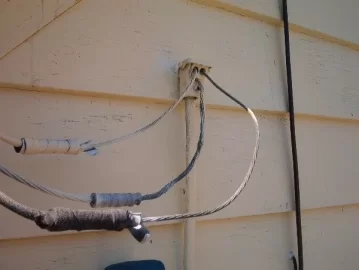

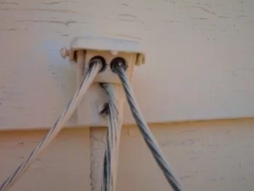

While we are on this subject the following pictures illustrate why "Ladders around powerlines" deserve special attention. Anyone painting, cleaning the chimeny, washing windows, or setting up a ladder against the side of the house pay close attention....especially if the wires coming into your home are on the "old side".
I found this condition at a customers house when they contracted me to "update the service to 200 amps.." I just stopped dead in my tracks and "stared in amazement" that it had never "blown up". Fellow electricians and linesman' know what they are looking at here. Home inspectors...and painters should educate themselves...as should anyone putting a ladder up next to something like this. Sad part is the young couple that just bought this house...had a home inspection done...and there was no mention of this condition...which leads me to my next sugestion:
If you are thinking of buying a home and want a REAL INSPECTION DONE...spend the extra money and have three professional opinions on your side: One from a reputable CARPENTER/GC, One from a reputable PLUMBER, One from a reputable ELECTRICIAN...I regualary do home inspections regarding electrical for a small fee...
You might save more than just money...

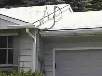

Ohh..And while we are at it, if you do decide to upgrade your service...do a quick visual inspection of the electricians work before you write the check. Best to ask the local inspector if a permit has been filed...and if it has been inspected and approved...so you don't end up paying for a plumber to do an electricians job...
This little "gem" was across the street from a service call I went on...I keep a camera in the truck for these "noteworthy ocassions":

keyman512us , hell of a lot of good pictures your posting. scary stuff in this thread i might add.
OK. No electrician here. What am I looking at and what is wrong with it?
I think that those three bare wires going in are HOT, NEUTRAL, GROUND. Could be very bad if they touched each other.

Keyman great pictures the service company could not have made those connections?
BB notice the bare wires from the overhead drop think in terns of wind rain and arking
the upper bracket is pulling off the building in another one
