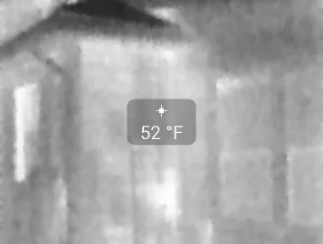

Finally got down there and fired it up, used the SEEK IR. I thought I took a bunch of pics, but I can't find them for some reason. What I ended up with:
There's still 2 spots on my kitchen ceiling that light up. Much smaller than before, but maybe I missed a couple of spots towards the edge. I'll recheck at some point. Got to thinking that all I'm doing is looking for variations in insulation, rather than whether it's adequate. Oh well. Other interesting spots:

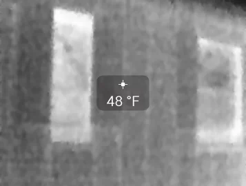

About 10 feet along 2 walls, in what is affectionately known as the "cold room". Same IR signature as my windows (which are energy efficient/gas double pane, though I don't know the R value). One of the other windows is old school single pane, and that lit up big time. So a bit of work still to do, but I guess not bad overall. I'll try to post the pics if I find them, or else take some more.

[Hearth.com] Lets see how my new insulation does... side of the house
[Hearth.com] Lets see how my new insulation does...old window on the left v new window on the right

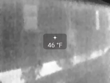

[Hearth.com] Lets see how my new insulation does... uninsulated wall on left, window on right

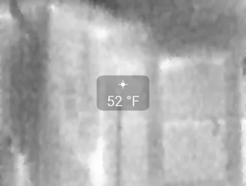

[Hearth.com] Lets see how my new insulation does... another view of the warm wall
foundation wall?

Yeah, that's the block wall abutting the crawl space. Looks brutal, right? Heat could be coming from crawl space, conduction down from the interior wall, or maybe radiation after being heated during the day.
Yup. I know it's only a vac home, and nobody likes crawling under the house, but next summer might be a good time to insulate there. Assuming a dirt floor in the crawl space, I'd dig or hoe a 1 foot deep trench along the inside of the foundation wall. Then put construction adhesive and some 1" foam boards against the inside block walls. Buy boards that don't absorb water, like Styrofoam or similar. Then back fill the dirt which you moved.
That's also a good time to inspect the insulation existing between the floor beams (might be none). Finally, roll out a thick plastic sheet to cover the entire dirt floor area of the crawl space. Assuming you've got some venting already, that'll cut down moisture issues if that's any problem.

Well, im definitely not trenching in my 2ft crawlspace, though i thought about insulating the walls. The floor is insulated and there is sheeting covering the ground. The question is if that heat is being lost from the crawlspace, or if it's being conducted down through the block from the living space above. If it's the latter, insulating the inside of the crawlspace won't be effective, though maybe insulating the outside would help. Here's the camera
