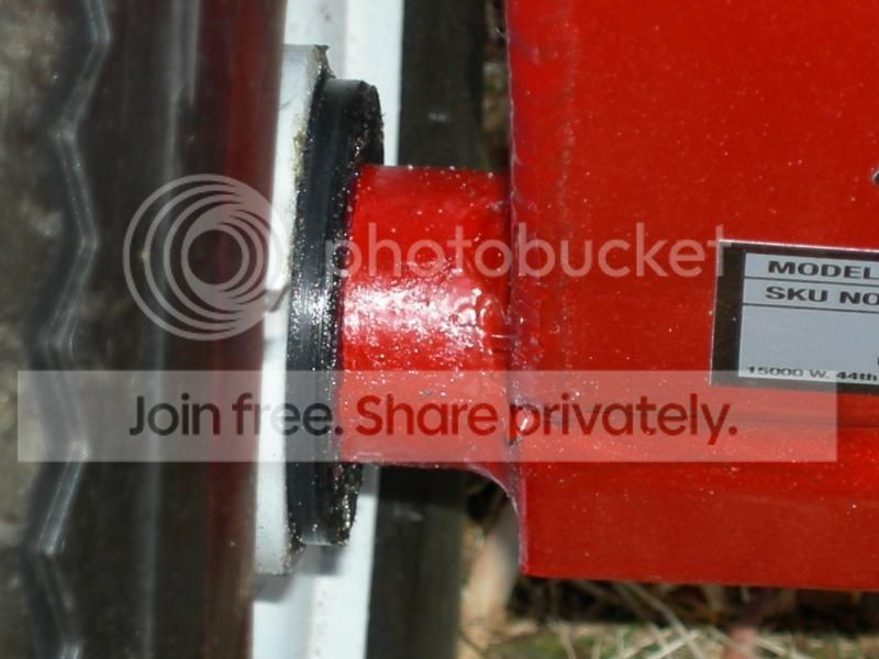

The issues I've had was a wheel bearing seal that would ride up over the axle shaft....
[Hearth.com] Let's talk about our Huskee 22....
I called Speeco, and I told them the nearest shop had a 6 week waiting list for service...they sent me a complete wheel / tire combo complete with bearings and seals to try (fixed).....FREE. Also had a couple of hoses leak (fixed under warranty), and the throttle linkage fell apart (red lever)....fixed under warranty, then fell apart on the trip home....don't bother with the lever any more. Did find that all the bolts holding the motor on the mounting plate loose (tightened)....gotta check them again next time out. Only had one round that it couldn't split, don't know for sure what it was.....I was told Sycamore....but it finally split it 6 months later.....can't beat it for the money
