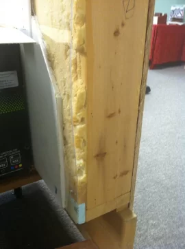

Soo Ive got some insulation work ahead of me after a water line freezing and bursting... Here's my scenario...
This is in my attic where it meets up against the warm side... It's studded out with 2x4 and they(someone before me) put r-19 in the cavity and then put up basic white Styrofoam to the cold side...
I was going to take it all out and replace it with r15 roxul and a r10 foam board but then I got to wondering that even though your not suppose to put r19 in a 2x4 cavity I wondered just how compromised is r19 in this situation...I mean is likely to still have a higher value than the recommend r13 or will it be lower...(It's not super crammed or pressed in there tightly but )
Secondly, not all of the r19 got wet and I do have a spot where I could use it what's still good, but having been in a slightly compressed state for at least several yrs is no longer going to be effective even in the right setting??

Some claim 6 inch thick R-19 compressed into a 3-1/2 in space is R-13 effectively and squeezed into a 5-1/2 inch space is only R-16.

Here is a link to an Owens-Corning table showing R values of various fiberglass batt products when installed to various framing cavity depths. In general, compressing the batt increases the R per inch of thickness, but decreases the total R due to the decrease in cavity depth.
(broken link removed)
As you see, the batt labeled "R19" is what it is tested to be at a thickness of 6.25 inch. Installed in a 2x6 cavity (5.5 inches deep), it's only R18. Compressed into a 2x4 cavity (3.5 inch), it's R13. It works fine that way, but just has the reduced R resulting from the shallower depth, even the R/inch has gone up from 3 to 3.7 per inch.
Be sure that you have the batt enclosed on all six sides. You don't want the unfaced side of the batt open to the air, or you'll get air currents moving up slowly through the batt, cutting its effective R value. Having the white styrofoam (EPS) on the outside serves the purpose of enclosing the batt to avoid the convective looping. It also is sufficiently vapor permeable to avoid "wrong side vapor barrier" issues. Having a thicker foam board on the cold side decreases the permeability of it, but the approach works fine if it's thick enough to keep the warm side of it above the dew point of inside air. Here's an article on how much thickness you need: http://www.greenbuildingadvisor.com...lating-minimum-thickness-rigid-foam-sheathing.

I agree with what Dick said ^^^. Sometimes when you shop for FG, you can find the R-19 costs the same as the R-13 on a sq ft basis. Then I always get the R-19 and compress it.
Your plan for changing out the FG + EPS for Roxul + R-10 will not likely make a big difference in heat loss. If the EPS is 1", and thus R-5, (you don't say) you might be going from R-10 for the 2x4 section (due to thermal bridging) + 5 (EPS) = R-15, to R-20. I would never waste time ripping out and replacing insulation to take the R-value from 15 to 20.
There have to be lower hanging fruit, likely in airsealing. It sounds like a kneewall, have you checked that the joists under the kneewall are airsealed?

I should've worded my original post better. I'm replacing the insulation due to the water line bursting and soaking the insulation that was there. About half was destroyed so im just redoing the whole wall. I can use the remaining good r19 elsewhere.
I don't believe the white styrofoam board that was there had any r value to it. So the 1" tuff-r foam should be a upgrade.

Not sure why you consider the existing foam board useless. That stuff is called EPS (expanded polystyrene). It is kinda fragile & flimsy compared to the pink board (XPS) but the r-values aren't much different. EPS about r-4 per inch. XPS = r-5 per inch. If it isn't busted up you can reuse it.
Priority #1 as Woodgeek states is air sealing the knee wall before re-insulating. Especially blocking the joist bays running from under the living space floor into the side attic. That may mean digging up some of the attic floor insulation to check.
Roxul should be easier to install perfectly & give you a bit better performance, but I'd spend the money on thicker foam. Same amount of work, more R-value, less chance of condensation in the wall.
