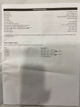

I dug out my manual and here is a bit more info. Under 13 pounds without oil or fuel for an 18 inch bar. These are the kind of saws you can pick up on sale. I believe there are ones that come with 18 and 16 inch bars. I like having the 18 inch, as the stuff I was cutting was over 18 inches in diameter. I have a 120V electric for trimming and cutting up branches.

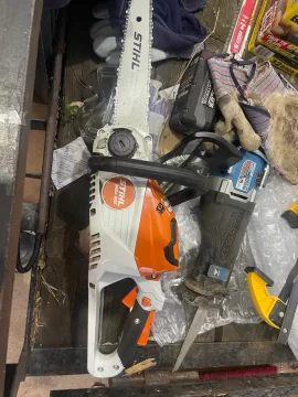

One of my customers was raving about their battery powered Stihl. Looks a little small for 10-14” logs, but he was happy, and it was light!
Not electric was a choice she expressed
Right. Hence mentioning it was battery powered. I saw it there, fondled it, and realized it was really light.
