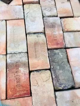

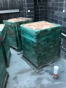

Would this old firebrick work for a hearth pad (under a new Pacific Energy Super LE)?
(broken link removed to https://www.kijiji.ca/v-renovation-flooring-wall/city-of-toronto/historical-reclaimed-firebricks/1572065781)
Since that link will eventually stop working, I'll attach photos below.

Yes, they're ok. The hearth should have a sheet of metal or cement board underneath if dry-laid as a barrier in case an ember falls between the cracks.
Cannot think of a reason why not. I used some years ago in building the floor of a large fireplace and it is still perfectly fine.
I also have a few left and use them on which to solder stuff and even make cuts with a torch. Just for an extra handy use.
It looks like a moderator combined my 2 posts into 1. Are you referring to the brick? Thank you.

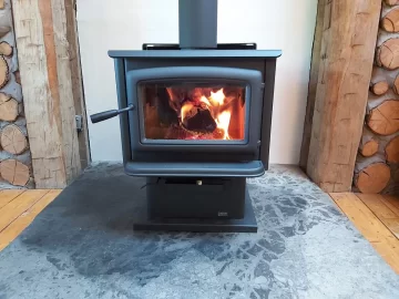

I'm building a simple hearth of flagstone over cement board. If I get big pieces of flagstone (i.e. heavy), can I just place them without wet-laying them? Or will I regret it?
Edit: The stove needs only ember protection - the flagstone is mostly for aesthetics.
First check what the stove manual says the hearth needs to be. But I would make the hearth as smooth as possible for cleaning.

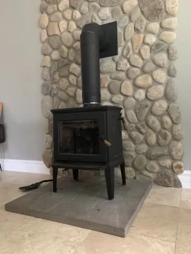

I am running a piece of flag stone just as you described with no issues. I did space it off the floor slightly with some stainless washers. Cleans perfectly fine with a hand broom, a spounge and some dish soap gets any stains out.
has been working perfectly, in fact I just moved it and there was zero floor damage underneath.
I did not use any sealer on the stone.
love the look and it’s was cheap, do consult your stove manual to make sure there is no required R value

For me yes one big piece 3.5’x3.5’ about 2 inches thick. I have a smaller stove though.
also my floor is also stone tile and therefor non combustible so I’m double covered. Like you my stove (hearthstone) specifies the need for ember protection only.

Update: I ended up finding a big piece of flagstone that was nearly the right size. I had to get a diamond blade for my angle grinder to make 1 cut, and then get 3 other guys to help me bring it in the house, but I'm happy with it. I didn't mortar it in - will see how it holds up. Thanks to everyone for the tips!
