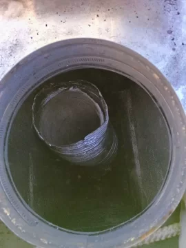

Hubby was cleaning the liner today getting ready for burning season . He noticed that the liner has come out of the clamp and dropped about a foot. What's the best method of lifting it up so it can be reclamped? Flexible corrugated liner. Thanks

we're trying to figure out how to grab the liner to pull it back up- seems lik we need something wedged inside it to pull

If you can reach in with gloves on (stainless loves to cut!), grab it and pull it up, always good to have two people. Hope there is enough give to get it back out and have enough tension to hold it down after you've re-attached. Two hands with vise-grips might be easier, whatever you can grab it with...
Is it just me, or does like liner look screwed up?
As far as pulling it up...I'd find a smaller kids kickball, deflate it, wrap a tiedown strap around it, stuff it into the liner, hand pump the ball back full, then you should be able to pull on the strap, held in by the ball....I dunno, might work, might not.
Edit: Or maybe its an insulated liner, and I'm seeing the inner liner and insulation?
Looked different to me too, but I do believe that its a lined system too. I kinda like the ball trick too, whatever works...
we used a boat fender( uninflated) put it in the pipe, used this handheld air compressor- inflated it to 10 psi then brought it up. clamped it in, then deinflated the bumper, tightening the clamp as we did.

Wow- glad you checked it, and good job for reminding BG! This for an insert? The liner stove adaptor should slide inside the flue connector and get connected with screws through the flue collar. And nice on being able to take care of this yourself.

yeah, the installer pretty much sucked on the install- it was held togeother(?) with foil tape. when they installed it they didn't adapt for the insulated liner ( bigger OD) and they had tried to tape/ cement it. I have the proper adapter coming.
