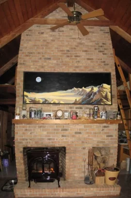

I have a set up similar to what you are describing. I went with an Olympia SS flex liner (about 20') that I installed myself. I did not insulate the liner except for stuffing fiberglass insulation around the top of the liner inside the chimney at the top where the brick chimney is exposed to the outdoors. I wanted to throw some heat inside my big chimney (8'x4') to take advantage if its thermal mass to release heat slowly after my fire dies out overnight. I can hit my chimney with an IR thermometer and get readings in the 90s on the backside, which is in the kitchen.
The main reason given [Hearth.com] Liner guidance for insulating liners is to keep the exhaust gasses hotter to minimize creosote build up in the flue. I only sweep my chimney once a year at the end of the season and never have any creosote, just fluffy soot. I do, however, have to clean my rain cap at least once mid-season or it will clog up. I have easy access to my roof and chimney, so this isn't a big problem.
The main reason givenView attachment 160975 for insulating liners is to keep the exhaust gasses hotter to minimize creosote build up in the flue. I only sweep my chimney once a year at the end of the season and never have any creosote, just fluffy soot. I do, however, have to clean my rain cap at least once mid-season or it will clog up. I have easy access to my roof and chimney, so this isn't a big problem.
Thats a pretty stove.
