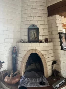

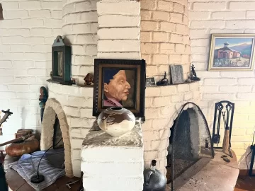

Good question! I am in a similar situation sorta.... Pardon me for somewhat hijacking this because I cannot find any way to start a new thread! I have a 20 ft chimney that is 14 year old, w a high heat ceramic (Orange colored "terracotta" I believe is not the correct description of this liner) flue liner that is surrounded by a MASSIVE real adobe brick that is aprox 2-3 feet thick on bottom tapering to about 12-16" (read Well insulated from the fairly warm SW new Mexico winter (average 35-60 degrees as low as 20 at night). I may be able to get a 6 inch stainless down the chimney but the professional carrer adobe fireplace builder says "Why, it should work fine without a liner as long as it is sealed well and I use the Outside Air Venting (on a Vermont casting Aspen C3 OAV stove). Chimney Co people (who install of course) say no I must use a liner. Thing is I would install liner myself but it woudl require a cutting out the existing flue. Why is my question. If anyone can tell me why or how to start a new thread please do! Thanks
View attachment 300680 View attachment 300681
What is the expected location of the stove exactly, and the expected flue connection plan?
It'd be nice to insert a stove into the fireplace so it doesn't take up too much floorspace.
Sometimes flue sweeping is horrendously worse when there isn't a full height liner. It depends on details.
the Stove flue center should be almost dead center in fire box. it is a beehive shaped Kiva Fireplace fairly small. Not sure what the diff between a full length liner and not. It is not ideal the stove will probably have to be pulled out for cleaning but actually the built in "Shelf" would probably catch the creosote. That said I am burning fossil hard dry dead down oak in a normal environment that seld sees the humidity needle go over 30% during the day usually 15-20 in summer. Seldom ay snow cover for more than a few hours to occaisioanlly a week or 2 max. In other words this i wood is DRY as a Dino Bone. flue connection is not ideal either as there will have to be a bit of a elbow right off the stove or nearly right off due to the shelf zig zag. No 90s just gentle s curves? Hard to say. I am not going to use the legs on teh stove and will excavate a channel in the bottom of the fireplace for the drop down for the OSAir exchange unit. The stove eventually will have a base of maybe 1 1/2" bricks supporting it inside the Kiva as the outer Hearth drops down into firebox about that far. I will have to notch out the outside lip of teh fireplace dome for the 16 inch width of stove up about 20" on each side.I hope this makes sense?
It may work fine we just don't know. But how do you plan on attaching your pipe to that 8x8 liner?
And I don't doubt that if your chimney is actually that thick you should be fine with regards to safety. But it still needs the same clearances to meet code
Unless there is something unusual about the baffle removal which would require pulling the stove for sweeping with a full length liner anyway, then it's highly likely that sweeping service will be 100 times easier with a full height liner. Even if pulling is required to sweep, it's still way better for sweeping with full length, in my opinion.
You usually don't really need to insulate the new liner when the terra cotta tiles stay in place. (This statement is not a haters invitation.)
And if you're doing the fireplace modifications yourself, then you are likely to be able to also install a full height flexible stainless liner yourself. It frankly is easier than setting up the tight connection of short piping to the damper area in many cases.
Just bust out the rear firebox upper area, and/or rear of damper frame in order to allow a relatively straight path for a stainless elbow at the bottom of the liner.
It does kinda suck that you have to notch the arched face brick. Don't forget that at some point of weakening the structure of the angled you are going to invite collapse of the upper center bricks and the little mantle area. If you could eliminate vibration hammering/chiseling of that face, it's advisable. Just cut out the notches with grinder/saw only. It may be possible to install a little quasi lintel/angle iron on the inside of the top of arch, but maybe too tricky given the curve, and unnecessary.
Having the ideal stove to fit there would be, again, ideal of course!
Wondering if it's possible to notch down into the whole hearth enough for the stove to sleeve in without changing the face arch. But big job, and it depends on what's below.
