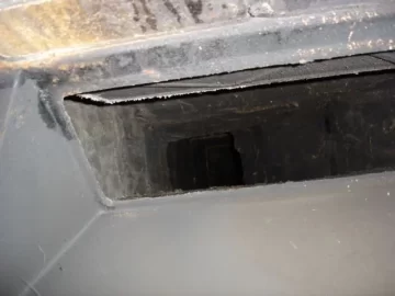

OK...had an idea today. I called my local rental center and for $168 I can rent a 35' cherry picker for the day. My buddy can get me the SS kit for $298. I'm guessing the insulation won't be too expensive(wrap type). I am paying a sweep to come over and inspect the chimney for $45. He will tell me the actual length and inside dimension of the flue. So now I'm thinking I might be able to pull this off. My only concern is the damper. If you see the picture, that opening is 5.5". Obviously the 6" pipe with insulation is not gonna make it. I'm thinking sawzall the stationary half of the damper enough so it fits through. OR should I cut both sides and try to close the door around the liner so I don't have to rig something to seal the entire opening? Thanks for your help!

I find a 4" gringer with a thin metal cutting wheel works best. Cast iron and sawzall blades dull rather quickly. After you push threw the liner it is easier to use sheet metal and tapcorns to attach a block off plate. Remember one can use multi pieces. When it is open like that is is quite easy. Sheet metal 2/4 pieces can be bought at Home Crapo
Elk... No problem and thanks for the advice. I do have a small angle grinder so I'll give it a try.
After poking around the net for a while I come upon these direct connect kits like the Ventinox brand. It looks like you can use one of these to get thru the damper without having to modify it and then seal/insulate around it. BUT...doing a search on this BBS, it seems people use these instead of installing a full liner. Couldn't I use the kit to get past the damper and then connect it to the full liner? OR...could I use a 6" liner and oval it at the bottom to get thru the damper? But if I do that I'd have to re-round it for the stove connection. Also, from what I gather, a 6" oval direct connect pipe is NOT the same as making a round 6" pipe oval. Basically I'd be willing to pay extra in order to avoid damaging my damper unless I could do it with the regular pipe.
