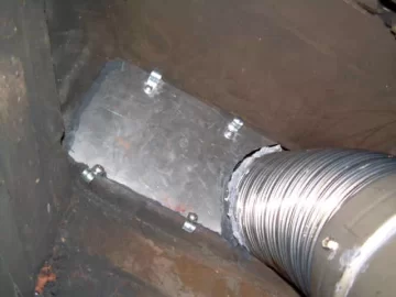

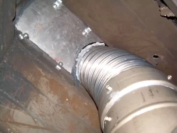

I installed a liner in my chimbley when I put in my Jotul Oslo. Used a 4" grinder to open up the center of the damper front and back, and then fabricated a left and right side block off plate to go around each side of the SS liner. I've attached a picture, and there is a more detailed description of how I did it.
The first thing I did after putting the ladder against the chimney was secure the ladder to the chimney by threading the strap from a ratcheting band clamp through a rung, passing one end of the strap around the chimney, and securing it to the ratchet. That way you don't have to worry so much (still worry, though) about bouncing the ladder off of the chimney while futzing with the uncooperative ss liner.
Here's a picture of the block off plate.
JotulOslo

JJ, Thanks for the link, it's exactly what I need. But, I think I can cut the pieces myself for much less than $76 and achieve the same thing. My bigger concern is using the correct gauge material. Are there any standards for a block off plate?
Thanks for everyone's help!
Niiiiiice! Thanks BB! Easy job indeed. I was told earlier tonight that I don't need a block off plate, but through some research here I've found that there are some huge advantages to doing so. Consider it done!
Happy now Elk?
